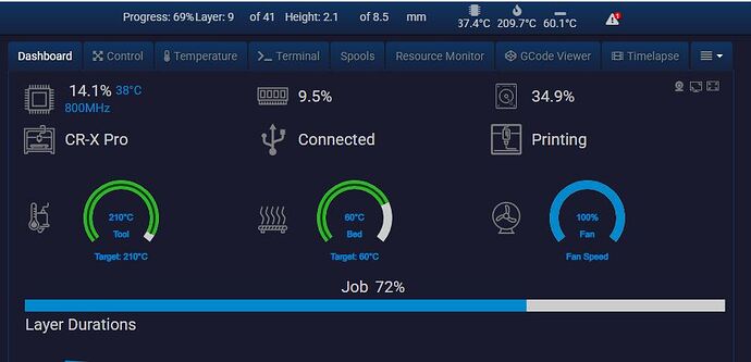

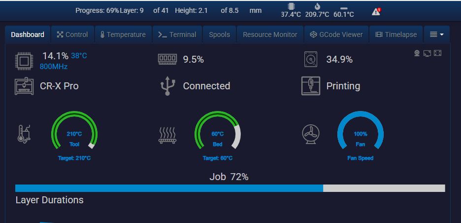

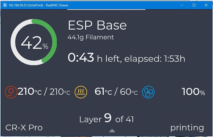

Just noticed that the Job Progress Sent by the API is different on my OctoDash to what is Reported in OctoPrint.
This is Also the Case on My oLED PrintMon by Qrome, that sits Outside.
Job Time, Time Remaining & ETA are all correct on all 3 Displays.

See Attached Images.
First screen Shot does not show Time Remaining, but it was 43 Minutes as Seen in OctoDash.
If you have PrintTimeGenius installed I know it overrides the percentage in OctoPrint's UI and not the API. The difference you are seeing is time based percentage created by that plugin vs OctoPrint's default progress percentage based on bytes sent/total.
