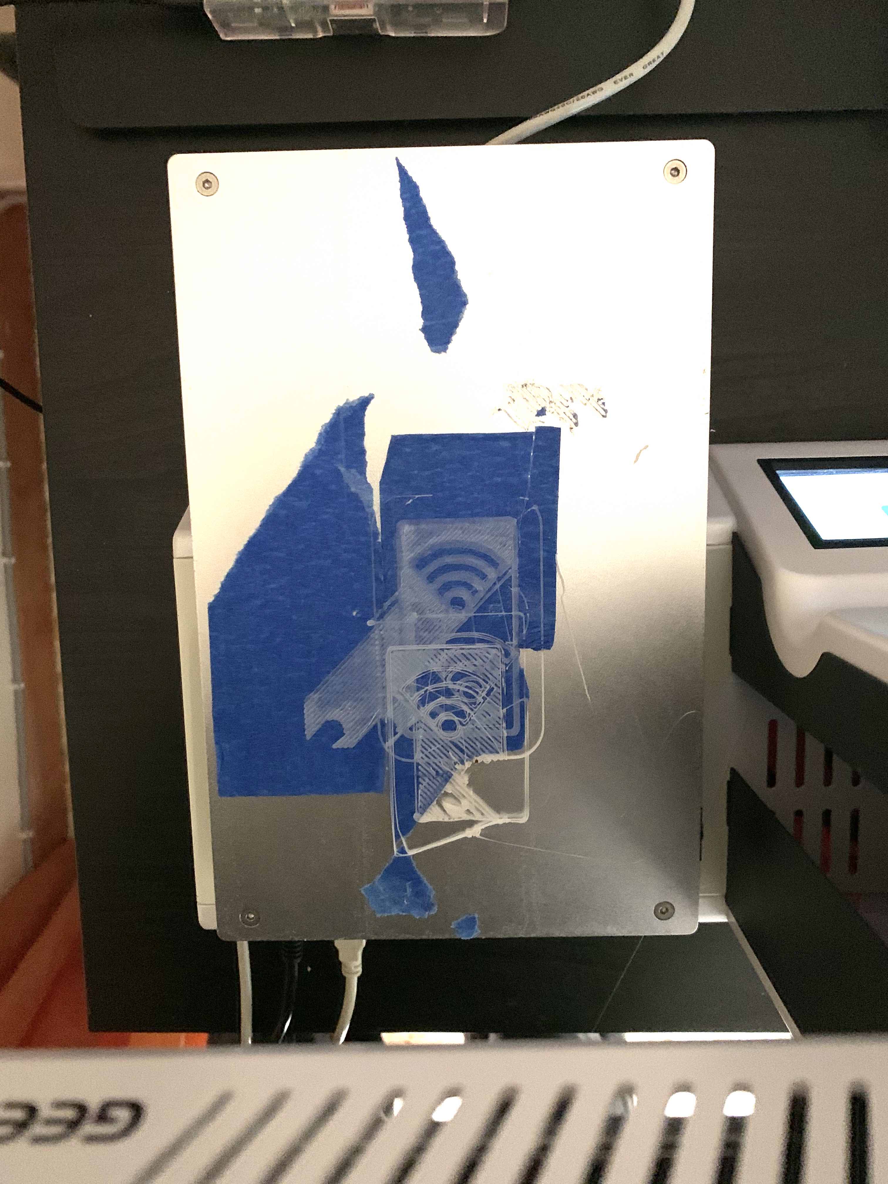

I have a GEEETECH E180 and to get my printed parts correctly I used the official slicer and software to control the printer (EasyPrint) and magically it starts to print correctly!
The same file, same gcode (exported from official software) dropped on octoprint jups around the plate misaligning every time!
I tried, raspberry 1, 3 and new power supply (as suggested) with no luck
Luckly for me i can review immediately as it start shifting layers on 3rd/4th layer after start
