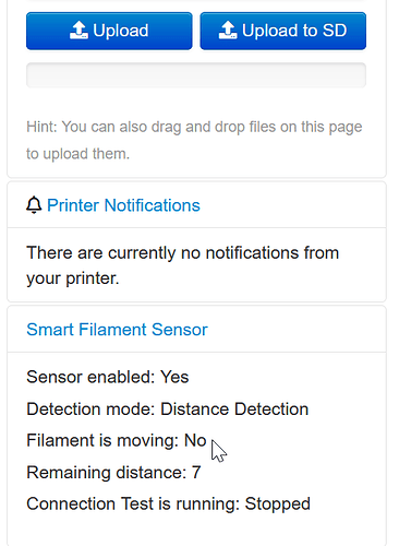

Did you take a minute to read that template you chose to delete in order to post that screenshot that 95% of the people viewing it have no idea what app and under what circumstance gave you that view?

'Can I get the BTT smart filament sensor status over MQTT?'
You don't need logs here. You don't need them to test it in safe mode. You don't need all the systeminfo stuff for a question like this.
In answer to the actual question from @Philly_Hot - it's unlikely you'll be able to get the filament sensor status over MQTT without writing extra code to do that for you. The Smart Filament Sensor plugin would have to be sending it's messages out to the MQTT plugin, which it doesn't do by default. For example, with the PSU Control plugin, there is an additional plugin you can download that will broadcast that status over MQTT, it doesn't do it automatically.
If you do fancy writing some Python code, it should not be too hard - if you do want to do that then we can help (possibly discord is easiest on the OctoPrint server)
