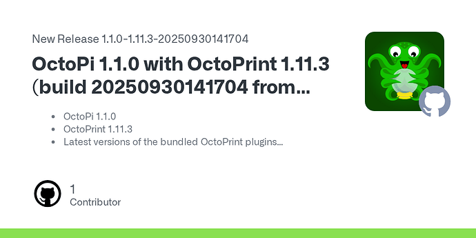

Good news. I was finally able to build camera-streamer again thanks to some upstream fixes, and have just built and tested a new image that should soon also be available on the imager.
For now you can get it here:
And the corresponding feedback ticket is here:
