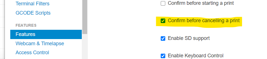

Is the option enabled?
Yes, but i did not want to disable that as a workaround just in case im butterfingers with clicking.
Disabling it now as a work around.
