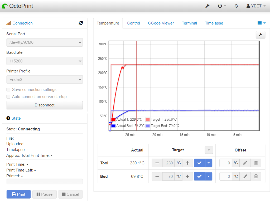

I've recently got my ender3v2 back up and working, and I've been trying to get octoprint to connect.
I can get the serial port to show up and baud rate is set to 115200 but the status will show connecting and be stuck there, but the hotend and bed temps are shown on the dashboard.
Terminal output:
Changing monitoring state from "Opening serial connection" to "Connecting"
Connected to: Serial<id=0xa7da4630, open=True>(port='/dev/ttyACM0', baudrate=115200, bytesize=8, parity='N', stopbits=1, timeout=10.0, xonxoff=False, rtscts=False, dsrdtr=False), starting monitor
