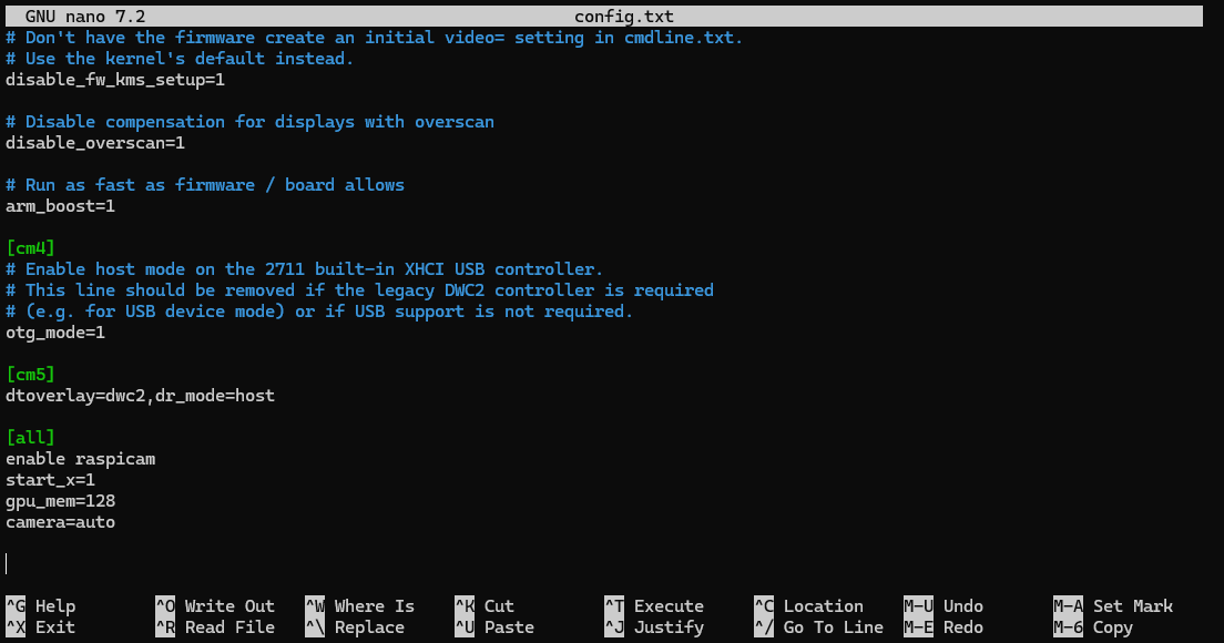

Same problem, but for me in config.txt raspcam enable was commented out, and finally, adding the line camera=auto at the bottom got my camera working again.
Cannot find anything in /boot/firmware/config.txt according to "raspcam" which is commented out.
Also there is nothing according to "camera=auto".
Could you please specify more precisely what did you do?
Thanks in advance...
Sorry for the typo. At the very bottom of config.txt (you have to scroll down) I found a line that was commented out that said "enable raspicam", i uncommented it, and, I added a line at the bottom that says "camera=auto" - sorry I don't know how to do the code thing. Camera=auto I think has to do with resolution, as some users said that setting resolution to lowest setting was working for them. Sorry, I'm not well versed on Linux/debian etc, I have to use google for everything, I am just reporting what worked for me, after updating to 1.11.4 and losing my raspicam.
Thanks for clarification.
enable raspicam was commented out too here, but after enabling it and adding camera=auto OctoPi does not recognize it...
