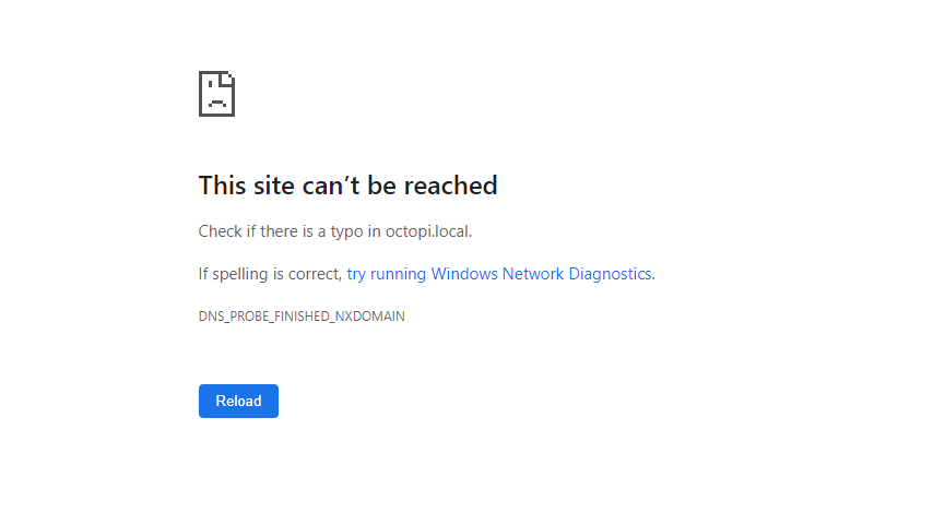

Have you tried accessing it using the direct IP-address? It may be that your local DNS resolver on the network may have issues with the "octopi.local" address and tries to resolve it using a regular DNS resolve which will fail.
Have you tried giving your Rpi a static IP address on the network? it may be that your computer's DNS cache is trying to access one of it's previous IP addresses if it's not a static IP and the DHCP server has released the IP and assigned it another.
By the looks of the error you get, it's a DNS issue "DNS_PROBE_FINISHED_NXDOMAIN", so try the above steps.

I think OctoPi is still working just fine, just that your connection to it isn't.
Yeah, I've tried the IP, but can't find it. I've been having problems with the IP changing sometimes too. The router say it's 'offline' when it is definitely online, which either means the connection sucks, which doesn't make any sense, since was working fine just before, the wires are having a problem, but that's not the problem, I checked that already. I'll try giving it a static address and see what happens then...
