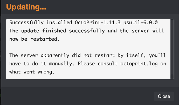

I get this result after every update:
What do you have configured in settings under server for the restart command? Typically this would only happen if the command is wrong or a plugin is somehow blocking the restart process. Looking at your octoprint.log, I would try disabling octopod to start since it seems to be having lots of issues.

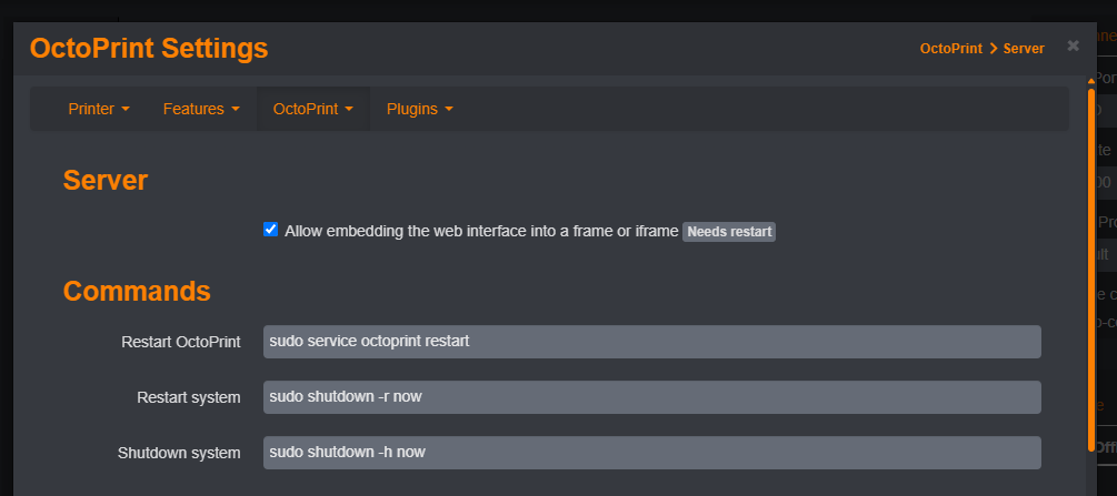

either you used octoprint_deploy or manually installed OctoPrint? depending if you setup the optional service or not would determine the restart command. for example, the default OctoPi image uses these in its settings.
I think deploy uses the instance name for the service file when you are setting it up.
If I remember, it was setup manually. In that case, what would the syntax for the restart command look like? I tried the one you kindly provided in the image, but it did not work.
