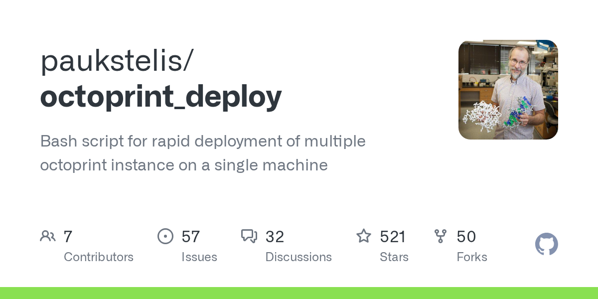

FYI...manually installing and adding service can be a pain. If you use octoprint_deploy it will handle all that for you.
