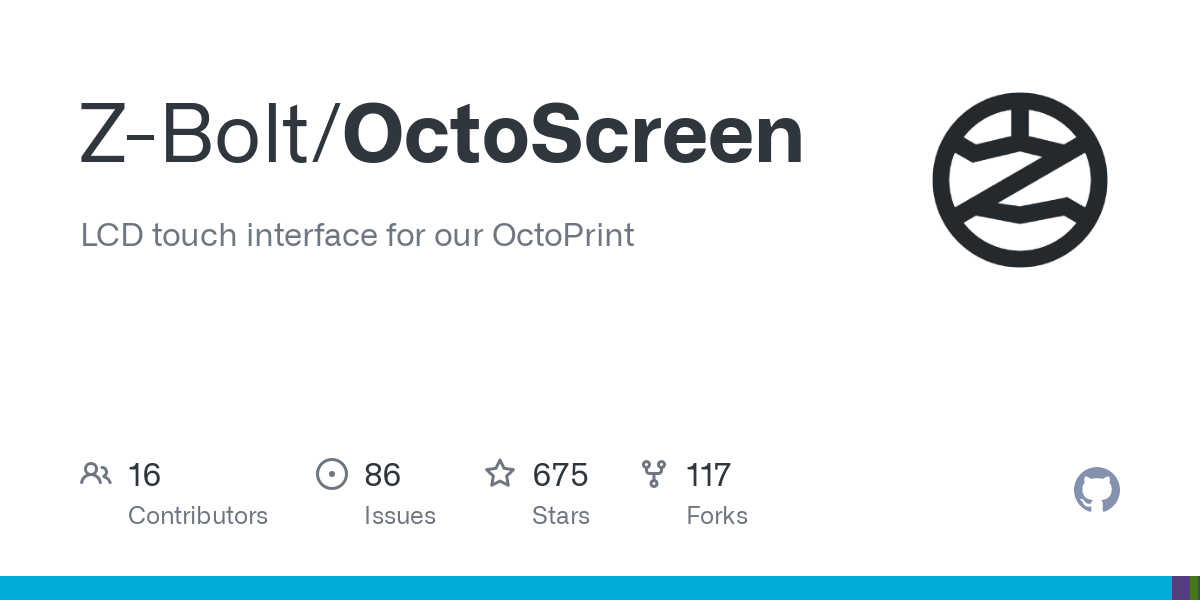

There is a product called OctoScreen that supports an extarnal touch LCD. But that one is not installed via the plugin manager.

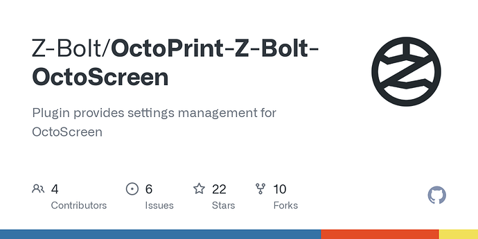

There is an associated plugin to that, which I assume is to allow it to pull some of the needed data for display in the main application that you linked, which would need to be installed separately.
Hi Ewald - thanks for replying. There appear to be two ways to install Octoscreen. One is via the link you provided, and the other is actually provided in the response after yours. In January I installed Octoscreen via the method you provided. Everything went smoothly. I had to reinstall, and now it has lost dependencies somehow and won't complete install. I posted about it on GitHub here:
My second raspberry pi also has the same issue when trying to install - so this is the currently the path of most resistance. If you have insight, please let me know. At the same time, I found the second method, which is installing it via plugin manager. You can install plugins by both finding them, or plugging in a URL to a plugin elsewhere to be installed. I can get that to install perfectly, but when I reboot... nothing happens. It should load directly into Octoscreen but doesn't. So I'm hoping that troubleshooting THAT issue is a lot easier...

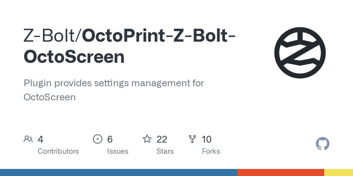

Hi jneiliii - The link you provided is exactly what I installed. Throw the .zip URL shown on that page into the plugin manager, and away it goes. Seems to install perfectly. There are no further instructions though... nothing else mentioned to be installed separately... where would it be?
Yeah, the plugin alone is not enough for OctoScreen to work. Your posted issue is probably related to Raspberry Pi Foundation doing stupid stuff and converting 32bit user space to 64bit during sudo apt update operations. We had a similar issue going on in the OctoDash group. I assume you did run the prerequisite commands for the dependencies? I see from your attachment in that issue that you did.

I think you are still confused - the app to display on a touchscreen can't be installed from within OctoPrint's plugin manager and it's not a plugin. It must be installed separately, this is what you are having trouble installing.
There is then also a 'companion plugin' that goes along with OctoScreen to enable extra features. This plugin alone is not the touchscreen app.
There's not two ways to install the same thing - there's two different things here.
