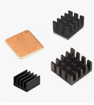

I suggest using heat sinks on the chips.

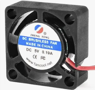

Keeping things cool, run a 5v 25mm fan;
With the right connector you can plug this straight onto the pi.

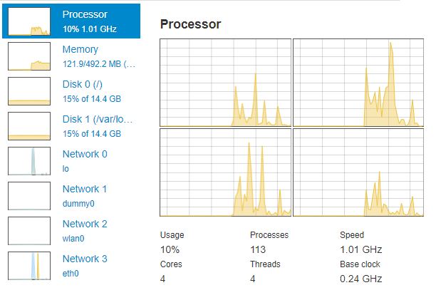

I suggest getting the 'Resource Monitor' plugin;
The biggest thing, you can monitor all of your pi info, specifically the temperature;

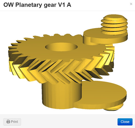

seemed to have an impact, curious if images could be added to the compression types for even more improvement (Slicer Thumbnails)?
Good question. Let me check into it.
Added the plugin, it says prusa slicer.
I am using cura currently.
Do I have to use prusa or can I just get the header of the gcode file to say prusa???
-JC
There are instructions on the plugin page on how to configure cura.
Like this????
That means it's working, but enable the inline option to show in the file list for all files that have the thumbnail extracted. The more files with thumbnails the slower the loading time.
pi3, for me, loading much faster and image is clearer.
Let me post the changes. I added to compress the image/png.
-JC

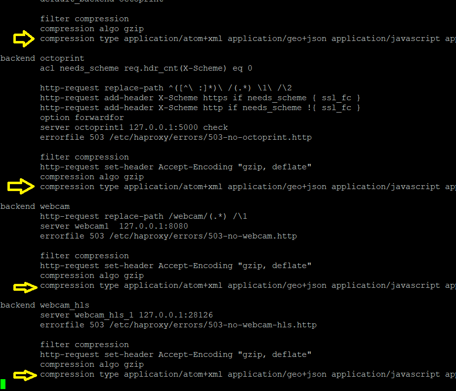

sudo nano /etc/haproxy/haproxy.cfg
Made a whole new list for this one.
Copy this line and paste over the Compression types in each section;
Compression type application/atom+xml application/geo+json application/javascript application/x-javascript application/json application/ld+json application/manifest+json application/rdf+xml application/rss+xml application/vnd.api+json application/xml+rss application/xhtml+xml application/xml image/png font/eot font/otf font/ttf image/svg+xml text/css text/javascript text/plain text/xml
