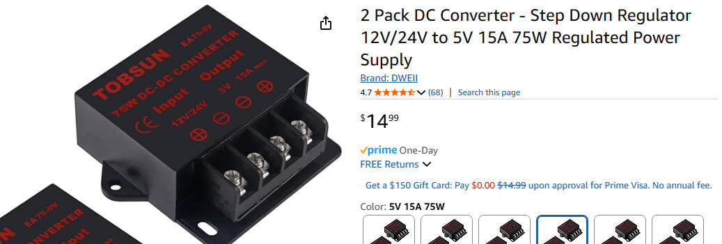

Most printers have a 24V main supply, I have used these in my Voron builds with good results.
The packaging makes them easy to mount.
Tought about it, but I'm also planning to add a relay to switch off the printer from Octoprint (to reduce the noise - my printer sounds like an helicopter at takeoff even when idle), so I can't rely on the printer's PSU
