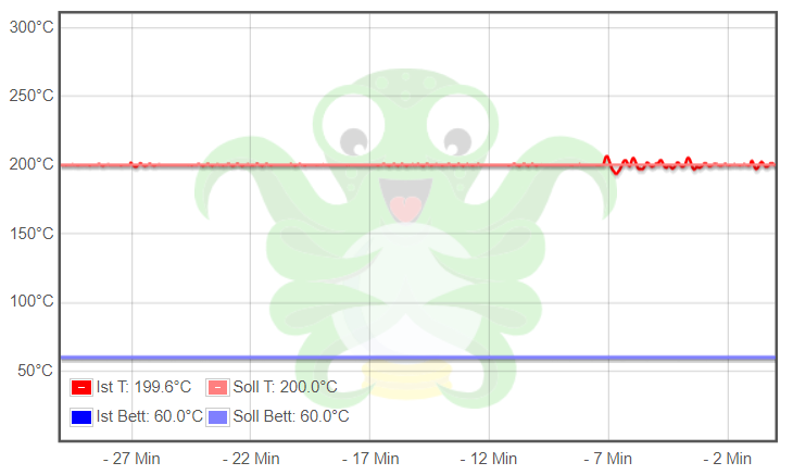

Sorry, that I didn't answer. @PrintedWeezl I used the same gcode both times. I sliced it again and this time I lowered the temperature by 5°C so I print on 200°C instead of 205°C. I am not sure if this was the problem. It's still printing at the moment.
Oh no, I forgot to activate it. But I am watching the print all the time at the moment and I saw something interesting. When it prints top layers, the part cooling fan turns off (I think for a smoother surface), but everytime when it does this the hotend temp has this bumps, also when the fan turns back on you see a drop down in temp. So I think it could be that the part cooling partially cools the hotend, too.

As I said before I started the print on 200C instead of 205C and it printed all the way through. The new fan duct is better in terms of the direction of the air. But it looks like that I should do PID Autotune anyways. Because, with the newer fan duct, the the cooling of the hotend fan is "better".
