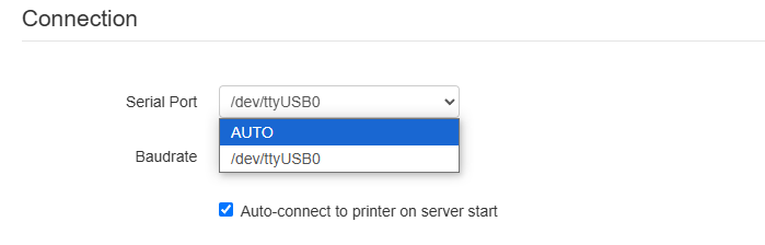

I just turned my printer back on after a few months. I got the message that updates are available so I pressed update which worked fine. Then I got the message that my python is nearing the end-of-life I looked up how to update that. I made a backup and reinstalled Octo print on my Raspberry pi 4. After uploading the backup, I noticed that my Octoscreen isn’t working anymore and I just get the classic Linux terminal. When restarting my printer and the raspberry PI I get the error message: “No more candidates to test, and no working port/baudrate combination detected.” Earlier then going Truong my settings Octoprint even found the port my printer was connected to when trying to switch between Auto and a specific por. Not it doesn’t even show that anymore. When trying to connect my printer to my pc running printer face I get some garbage messages since Klipper is relying on the raspberry pi to communicate to my PC.

I just uploaded a Backup of my Printer.cfg and now it at least detects my printers usb port but I still can't connect to it. The error message I get is "no more candidates to test".
