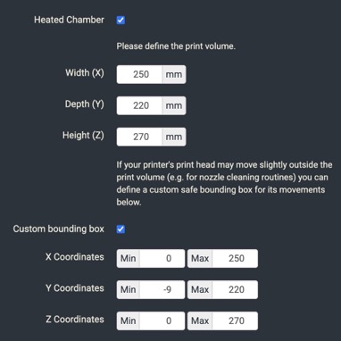

I created a new printer profile for the Core One. I did some research and found the recommended sizes have changed, so I changed those on the Core One profile:

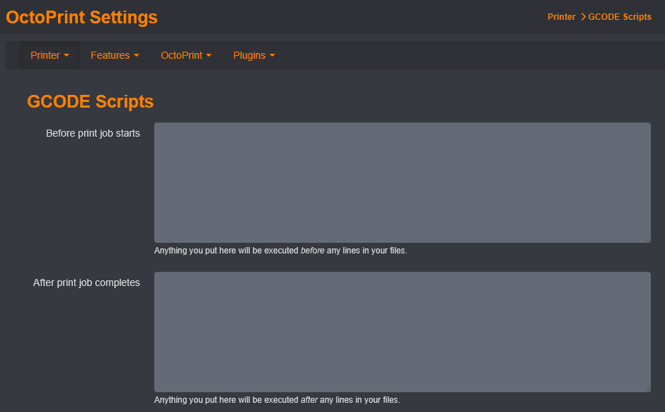

These are my settings in OctoPrint for the Prusa XL:

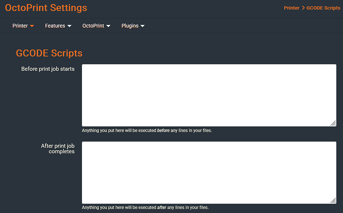

And for the MK2.5S I have:
