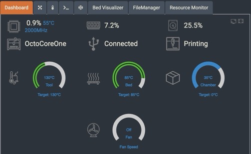

@jneilliii - I installed your plugin as mentioned above and I see the chamber temp, however the "target" temp shows as 0. If I look at the display on the Core One, it says the "target" is 35. Am I missing something?
screenshot 2025-06-24 at 08.48.08
It's an issue with how prusa is reporting this information. There is an open pull request to make this work natively and I assume that includes target temp data.
