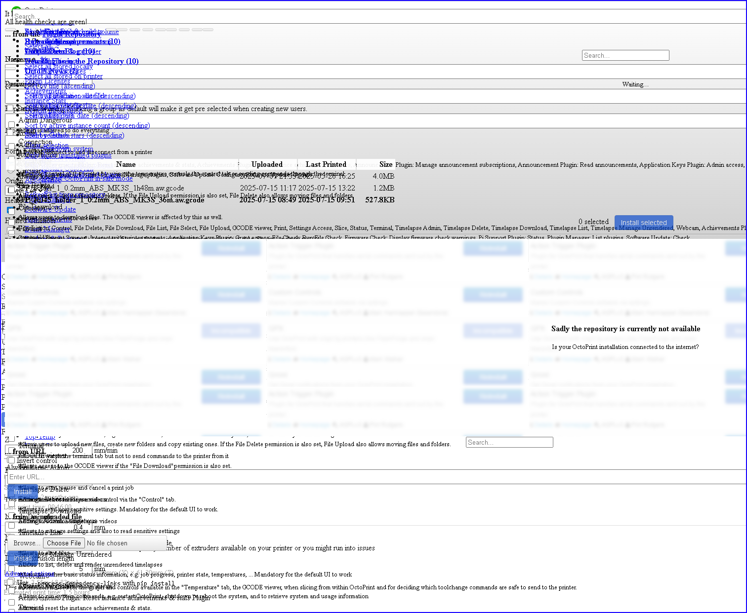

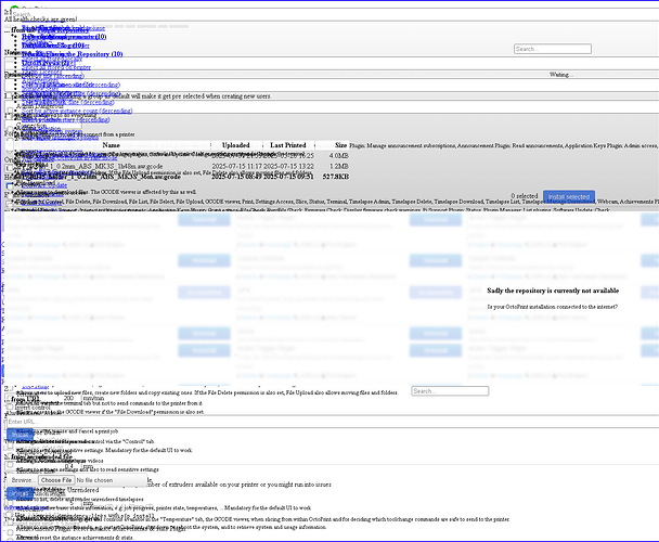

Here is an example of the consequence after apply the cli:
sudo apt full-upgrade
Have you done a Crtl-F5 to clear the browser cache?
thank you Ewald, thats a very good shout, I will give that a go and report back
I re-imaged the pi, but worked out that the ports cannot be the same as below:
bind :::8443 v4v6
bind :::8443 v4v6 ssl crt /etc/ssl/snakeoil.pem
They need to be different like this, which worked well:
bind :::8443 v4v6
bind :::443 v4v6 ssl crt /etc/ssl/snakeoil.pem
