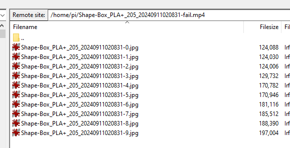

I tried echoing $2 to the same file and it throws errors for some reason, but mkdir seems to work fine. It creates a folder named what the output filename would be in the timelpase folder, notice the fail added to the end because it was rendered after cancel.

updated test.sh...
#!/usr/bin/bash
mkdir $2
clipped_string=${1:0:-11}
cp $clipped_string*.jpg $2
the above will strip the end of the input token string using bash shell parameter expansion , create a directory in timelapse folder named based on the timelapse job, and then copy the files from tmp to that location.
EDIT: the only downside is that because the file ends up in the timelapse folder it is listed in the rendered tielapses section but because it's a folder, you can view it or download, etc...
this wouldn't be an issue if you were sending it elsewhere though...
Besides my edit above, one other thing I noticed is that {output} is actually naming the file preceded by ., making it hidden until the rendering process is completed, but again not relevant unless you decide to use it in your script. The folder was getting renamed removing the leading . on render completion.
