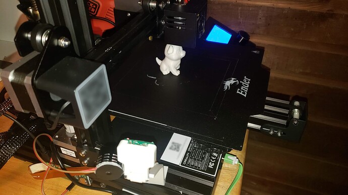

So, I believe, I'm allset with that feature: installed it today and it works like a charm! Don't need web UI controls, actually; I'm open Android client, lights is on, close/switch to another app - lights turned off, pretty useful for controlling printing process in the dark basement. Here are the pics:
Ender 3 Pro with RPi Zero W + cam + flashlight head (will print a proper cam & light holder when I learn some CAD
Screenshot in full darkness (only RPi/OctoPrint flashlight is on). Should be more brighter (and probably will be
) but it's OK for now - model (and possible mess or issues) are visible.
