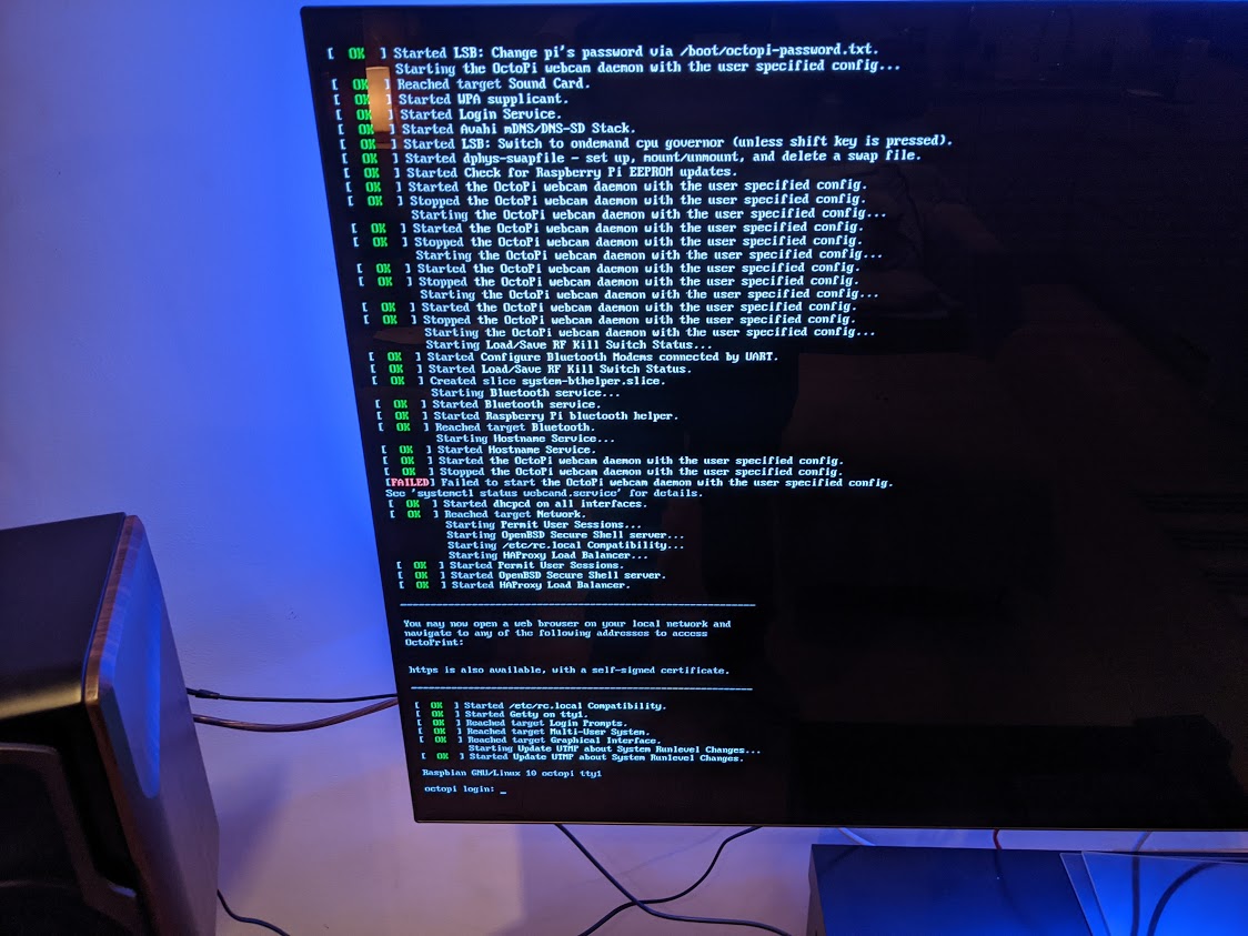

OctoPi doesn't ship with a desktop preinstalled, it is meant to be used headless over the network. Configure wifi as outlined in the setup instructions, try to access it then. So far it really sounds like your display is simply not being recognized and everything else working just fine.
Thx for the reply, planning to connect it with my TV later tonight.
I installed Octoprint on my Windows laptop, that works like a charm. Just wanted to install it on my PI, but like i say, i could not see anything so i concluded it was not working. I was also a bit mislead by the messages over the bluescreen issues people encountered?

Make sure you install the desktop, as it says in that little intro message once you login. That might be all the problem is (famous last words), the other screen doesn't support the console output.
