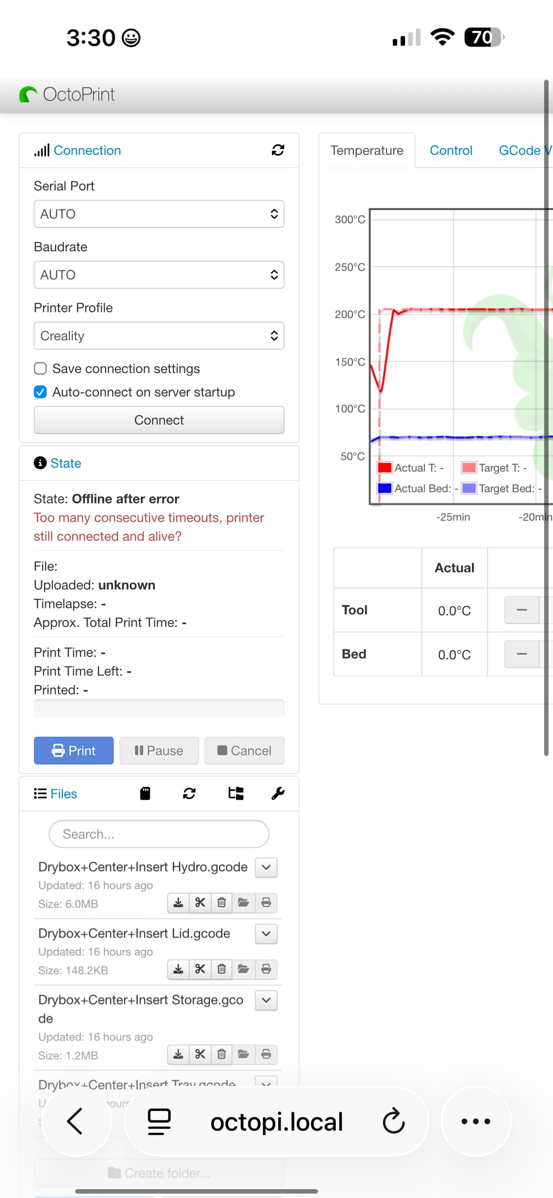

OctoPi loses connection during printing. After starting a print I cannot pause or cancel a print. When attempting to do so the conneciton times out and printer goes on printing.
My system worked without issues but since upgrading my Network controller to a Unifi Cloud Gateway it's been nothing but issues with my OctoPi. I'm convinced this is related to a setting on my Unifi system but I'm not sure which.

  1. Cannot upload files from a Windows PC, I can access the UI via static IP from my PC and control the printer (temp, home, etc) but when I upload a file it doesn't upload. The upload bar starts but than the bar freezes. I can however upload files from my iPhone without issues
Fresh install of OctoPi
Static IP
Disabled Power Save Mode via SSH

Printer: Ender 3
Raspberry Pi 3 Model B
Network: Unifi Cloud Gateway Max and Nano HD AP
