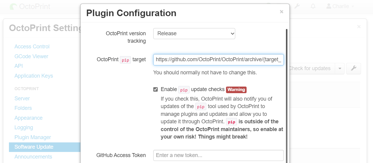

The script tries to run this:
/home/pi/oprint/bin/python -m pip --disable-pip-version-check install https://github.com/OctoPrint/OctoPrint/archive/1.8.0.zip. --no-cache-dir
But I get this:
ERROR: HTTP error 404 while getting https://github.com/OctoPrint/OctoPrint/archive/1.8.0.zip.
ERROR: Could not install requirement https://github.com/OctoPrint/OctoPrint/archive/1.8.0.zip. because of HTTP error 404 Client Error: Not Found for url: https://github.com/OctoPrint/OctoPrint/archive/1.8.0.zip. for URL https://github.com/OctoPrint/OctoPrint/archive/1.8.0.zip.
SSH --> CopyPaste the command above --> removing the trailing dot after zip --> Works fine

Have had this issue for quite some time but it's not a big issue as I work around it. Just now upgrading to 1.8 I got it (as usual) and thought I'd try to fix it or report it as a bug should it be one...
Nothing gets written to the logs
