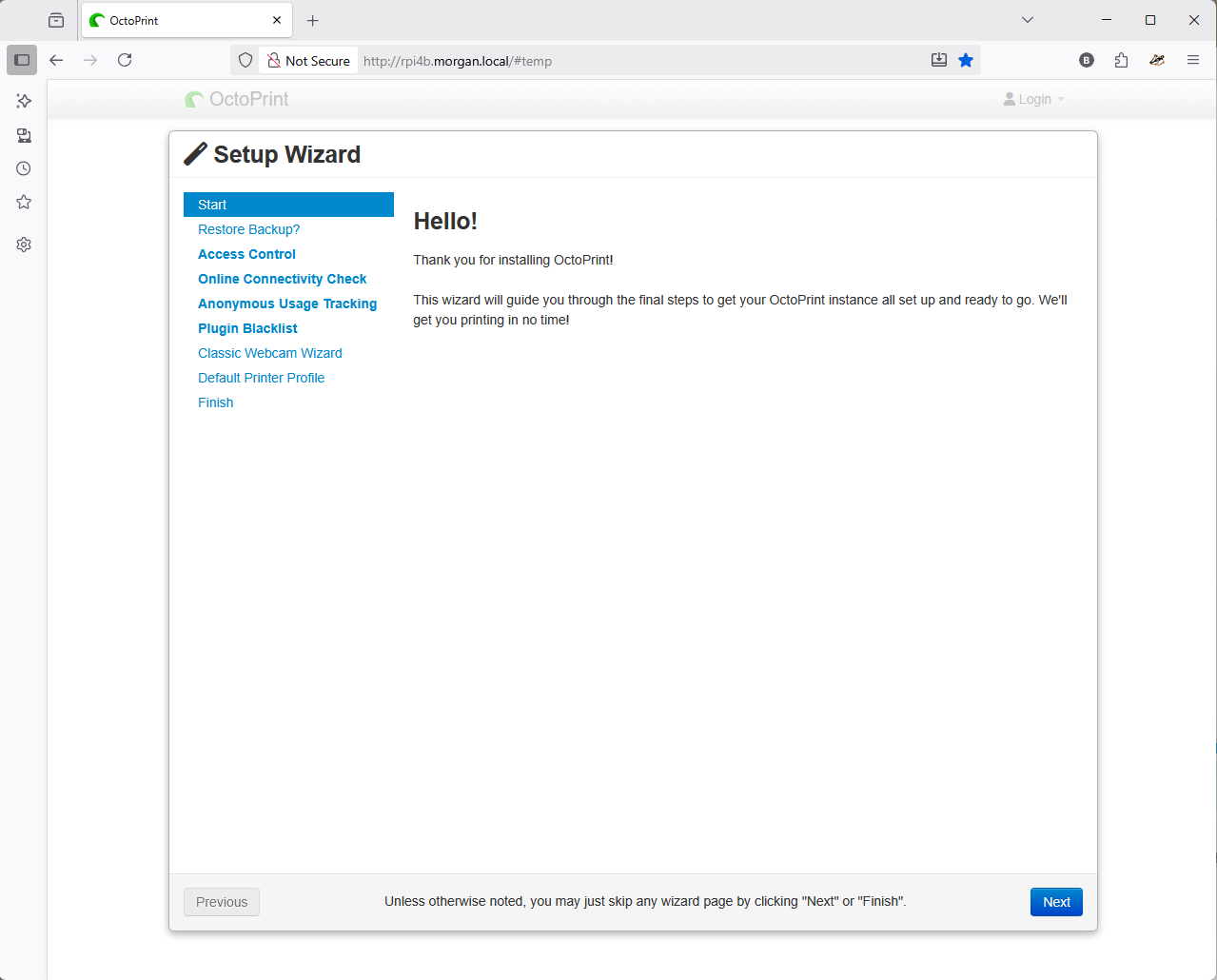

What model Raspberry Pi do you have? Exactly which image did you use (version number is on the RPi Imager page where you select the image)?
After writing the image on the SD card and booting the RPi with that card, opening the RPi IP in your browser should respond with the Setup Wizard as shown below. On this page you click "Next" and then upload the backup you saved from the previous version.
If the RPi went directly to the "Please Log In" window, then something is obviously wrong. While the video you used is 5 years old, I just checked on my RPi and the instructions are still valid. Make sure you are looking in the hidden directory .octoprint, not the OctoPrint directory.
I'd suggest that you start over and re-image the SD card. When you boot the RPi, it will take a while to do all the OS first run stuff before the OctoPrint web server is available.
