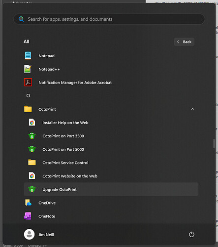

It appears that you used my windows installer to create your OctoPrint instance. If you need to upgrade OctoPrint there is an item added to the start menu under the OctoPrint folder that can be used for this.
