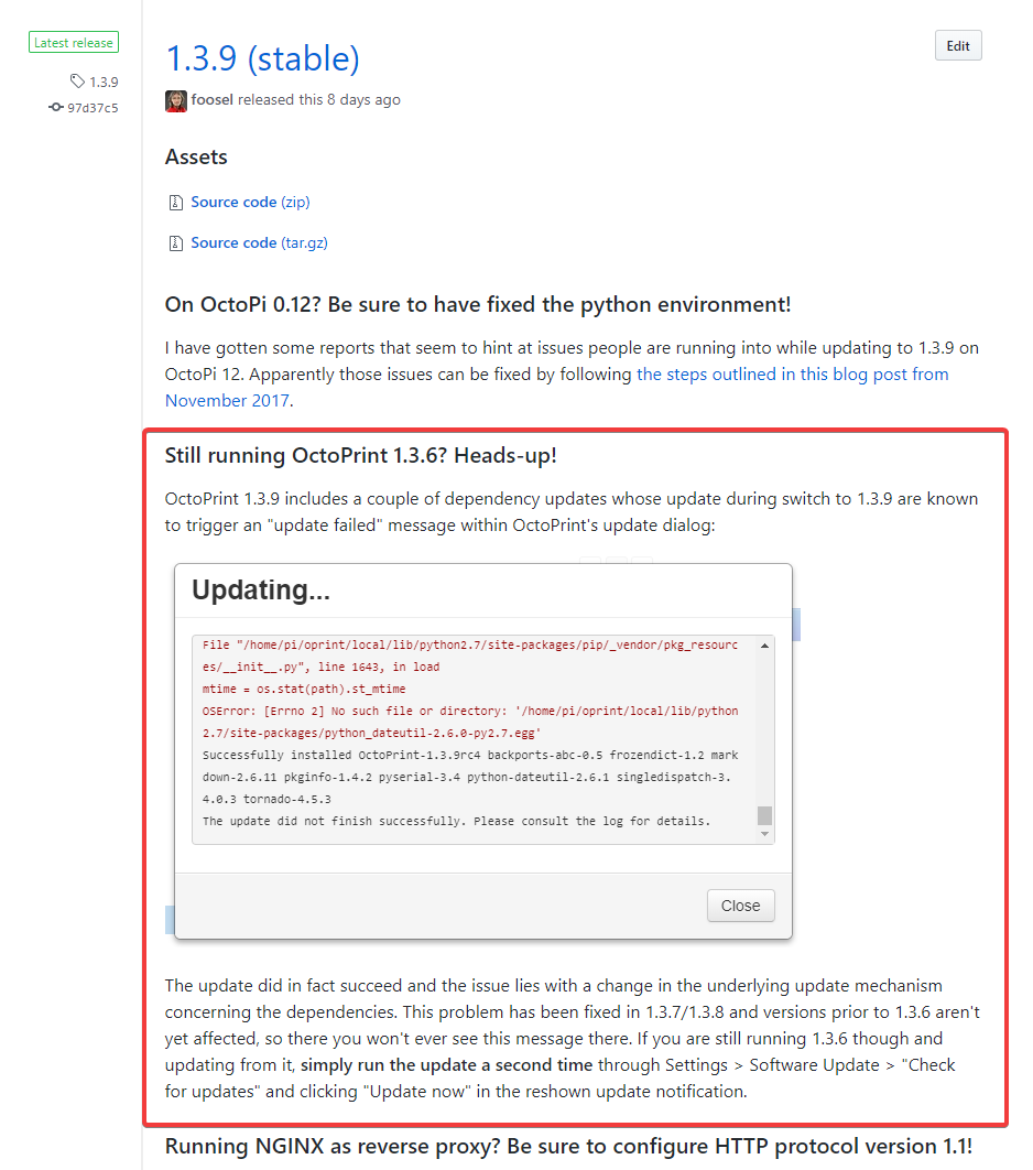

My upgrade from 1.3.6 to 1.3.9 reported failure.
Tried to search the logfile and the forum.
The logfile states:
2018-08-02 13:15:56,392 - octoprint.plugins.softwareupdate - INFO - Starting update of octoprint to 1.3.9...
2018-08-02 13:17:09,090 - octoprint.plugins.softwareupdate - ERROR - Update of octoprint can not be performed
File "/home/octoprint/OctoPrint/venv/lib/python2.7/site-packages/OctoPrint-1.3.6-py2.7.egg/octoprint/plugins/softwareupdate/init.py", line 908, in _perform_update
File "/home/octoprint/OctoPrint/venv/lib/python2.7/site-packages/OctoPrint-1.3.6-py2.7.egg/octoprint/plugins/softwareupdate/updaters/pip.py", line 81, in perform_update
UpdateError
The message from the screen:
Running setup.py install for OctoPrint: finished with status 'done'
File "/usr/lib/python2.7/runpy.py", line 174, in _run_module_as_main
"main", fname, loader, pkg_name)
File "/usr/lib/python2.7/runpy.py", line 72, in _run_code
exec code in run_globals
File "/home/octoprint/OctoPrint/venv/lib/python2.7/site-packages/pip/main.py", line 19, in
sys.exit(pip.main())
File "/home/octoprint/OctoPrint/venv/local/lib/python2.7/site-packages/pip/init.py", line 248, in main
return command.main(cmd_args)
File "/home/octoprint/OctoPrint/venv/local/lib/python2.7/site-packages/pip/basecommand.py", line 252, in main
pip_version_check(session)
File "/home/octoprint/OctoPrint/venv/local/lib/python2.7/site-packages/pip/utils/outdated.py", line 102, in pip_version_check
installed_version = get_installed_version("pip")
File "/home/octoprint/OctoPrint/venv/local/lib/python2.7/site-packages/pip/utils/init.py", line 838, in get_installed_version
working_set = pkg_resources.WorkingSet()
File "/home/octoprint/OctoPrint/venv/local/lib/python2.7/site-packages/pip/_vendor/pkg_resources/init.py", line 644, in init
self.add_entry(entry)
File "/home/octoprint/OctoPrint/venv/local/lib/python2.7/site-packages/pip/_vendor/pkg_resources/init.py", line 700, in add_entry
for dist in find_distributions(entry, True):
File "/home/octoprint/OctoPrint/venv/local/lib/python2.7/site-packages/pip/_vendor/pkg_resources/init.py", line 1949, in find_eggs_in_zip
if metadata.has_metadata('PKG-INFO'):
File "/home/octoprint/OctoPrint/venv/local/lib/python2.7/site-packages/pip/_vendor/pkg_resources/init.py", line 1463, in has_metadata
return self.egg_info and self._has(self._fn(self.egg_info, name))
File "/home/octoprint/OctoPrint/venv/local/lib/python2.7/site-packages/pip/_vendor/pkg_resources/init.py", line 1823, in _has
return zip_path in self.zipinfo or zip_path in self._index()
File "/home/octoprint/OctoPrint/venv/local/lib/python2.7/site-packages/pip/_vendor/pkg_resources/init.py", line 1703, in zipinfo
return self._zip_manifests.load(self.loader.archive)
File "/home/octoprint/OctoPrint/venv/local/lib/python2.7/site-packages/pip/_vendor/pkg_resources/init.py", line 1643, in load
mtime = os.stat(path).st_mtime
OSError: [Errno 2] No such file or directory: '/home/octoprint/OctoPrint/venv/local/lib/python2.7/site-packages/pyserial-2.7-py2.7.egg'
Successfully installed OctoPrint-1.3.9 backports-abc-0.5 frozendict-1.2 pkginfo-1.4.2 psutil-5.4.6 pyserial-3.4 singledispatch-3.4.0.3 tornado-4.5.3
The update did not finish successfully. Please consult the log for details.
