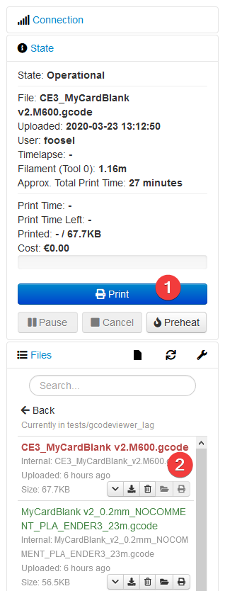

When a print fails due to bed adhesion, jammed filament, etc. I may need to cancel it and start over. The print will cancel fine but then the Print icon remains disabled unless I restart Octoprint. I used to be able to just refresh the browser to get the button reactivated.
In all versions including 1.4.0, the one with 2 will stay disabled since it's not actually "print this file" but "select and then print this file" - and what is already selected cannot be selected again and hence 2 will be deactivated for the already selected file up until 1.4.0. Since that's caused too much confusion though I've pushed a patch for 1.4.1 that will keep 2 enabled as well.
