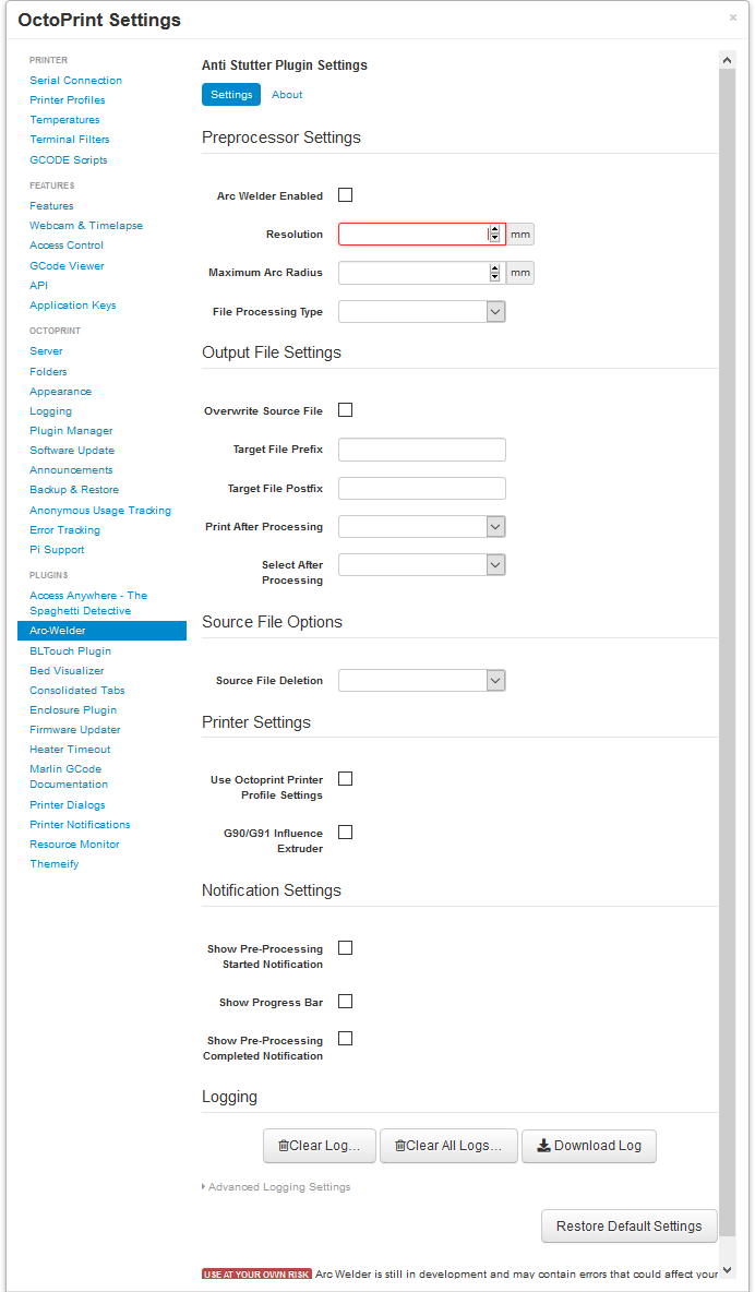

ALL my plugins broke. None of the settings that were last saved are visible in the settings menu. Most of them don't even display settings at all, and 'restore default settings' doesn't work. Majority of the buttons on the various plugins also currently have no effect. This includes attempting to modify the settings for the plugins in the setting menu.
All that said, the plugins themselves appear to be working, but the UI is broken. The enclosure plugin is reacting to button presses and firing outputs based on how it was set up. Arc-Welder is processing the uploaded files, but there is no display that a file is being processed or has completed. The Spaghetti Detective is sending "Print Complete!" emails before the printer even performs a G28, which is a new symptom since these issues started)....

As you can see in this above screenshot, some elements are loaded in, but others are not. But nothing is proper. The temperate reading isn't working, I don't have a PWM or NeoPixel in my config at all, nor an LED Strip. The filament sensor is named 'FilamentDebug1' in my config. But even then, the buttons shown are both options, instead of just the picture that should be shown. (Turn Off and Turn On buttons, where it should be just one or other)
There are defaults that would be filled in here, but I also have 'M600' in the filament change section. All of that is missing.
