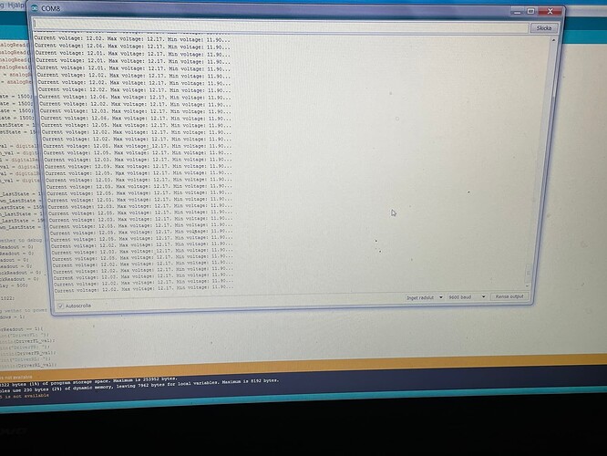

I'm still worried about the PSU not being good for some reason, I don't have expensive logging equipment but I think an arduino can do the job.
Initially using a 16x2 LCD.
This quickly showed issues of data corruption both when hooked up to to the 12V line of the printer(for measuring/logging, not powering arduino) and when disconnected.
It ran fine when I moved it further away from the printer setup which makes me highly suspect EMI issues.
Added a capacitor across VCC and GND which helped slightly when not connected to the 12V line, once connected it didn't help anymore.
Those LCD's are semi-known for being sensitive so rewrote the program to work over serial instead and directly monitor from my laptop.
All it does is measure as often and fast as possible and then save/show the min, max and current values once a sec.
ie the values refresh at the max speed arduino can handle(10k per sec or something) but I refresh the serial less often to not spam the terminal..
Will do another testprint and see if it can catch any voltage drops.
