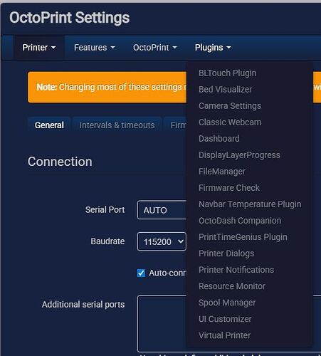

And Plug-ins as Listed Here:-

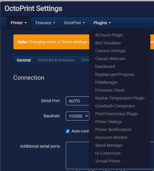

The "New Camera Stack" Build I Tried is this...
Capture
This was related to Piwheels currently has certificate issues, updates might fail due to this, should be working now.
