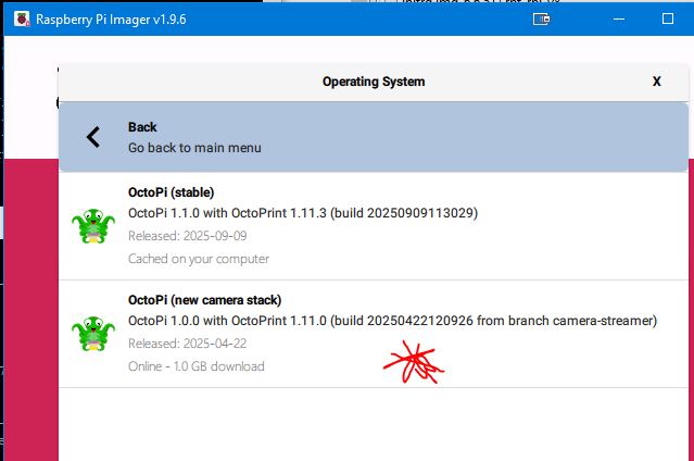

Also Tried another SD Card with the New Camera Stack, as I have two USB Cameras.
The SD Card Booted Ok & my Backup restored, but the install refuses to update.
Errors saying the SSL Certificates have Expired.
The "New Camera Stack" Build I Tried is this...

This was related to Piwheels currently has certificate issues, updates might fail due to this, should be working now.

Better sooner than later but you have to make that call for yourself, as you mentioned you've been running tests. The new camera stack has been updated since your screenshot and should be both based on OctoPi 1.1.0 now.
