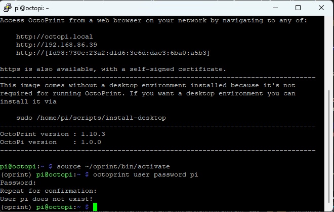

I followed the "forgot password" FAQ and logged into the SSH using PuTTY. When I attempted to change the password on the user "pi" (or for any other attempt) the response is "User does not exist".

thank you for the quick response b-morgan. Understood, I am able to log into the OS using the user/password set during the image creation. I followed the instructions for resetting an OctoPrint user (2nd set that you are referring to). I provided a screenshot of my SSH session, it shows that for whatever username I enter it says it does not exist, including the default "pi/raspberry" entry. Unfortunately I blew away the older version that worked just fine, now I am stuck. When the new image came up, it did not initiate any setup wizard, is that because I pre-entered my SSID info and OS user/password in the initial settings of the Raspberry Pi imager? Once booted, it goes directly to the username/password screen as shown:

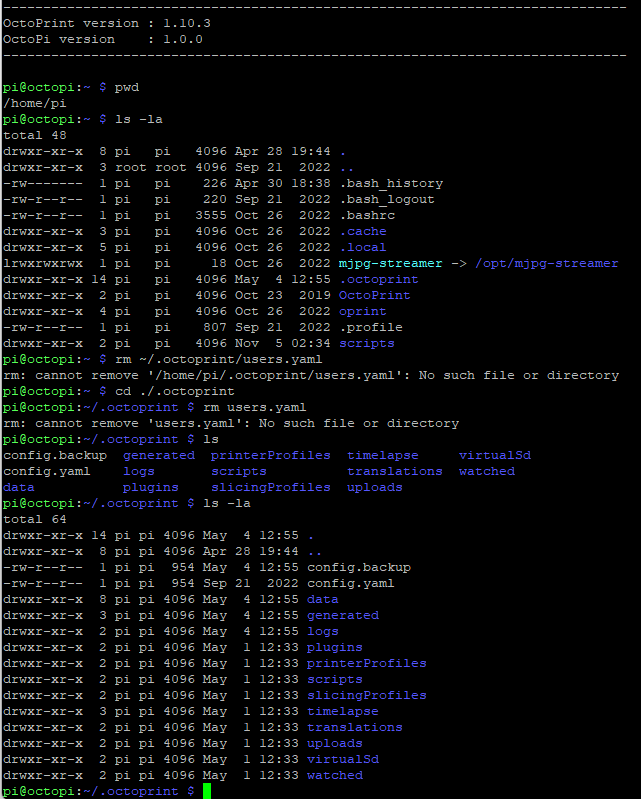

Can you post the output of pwd and ls -la. Note that the directory is .octoprint. Directories that start with a period (.) are normally hidden so they don't show up unless you ask nicely :sweat_smile:.
While the instructions page says 1.3.12 those three commands will work (I tested it) on OctoPrint 1.10.3 and 1.11.0.
thanks again b-morgan, I eventually found time to get back to this and for the reminder of the purpose of the "." for hidden directories! Here is the screenshot of the PuTTY session:
However, since I did have a backup I discovered that the backup file contained the "users.yaml" file, so I copied that over to the .octoprint directory and then I was able to use my existing user login and now back in business. Thank you for your suggestions and the exercise reintroduced me back to command line!
