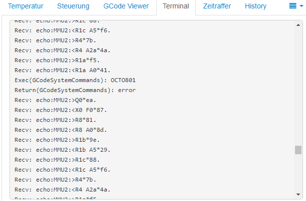

Curious if you see the command being sent on the terminal tab when you click the button?
Hello! I didnt check it before.
Here is what shows up:

I have done like this and still the same output in the terminal.
config.yaml (3.5 KB)
Output:
Exec(GCodeSystemCommands): OCTO801
Return(GCodeSystemCommands): error
Turn the light on from the command line. Then click the OCTO802 button and I bet it will turn it off. Test now and get back to us!
