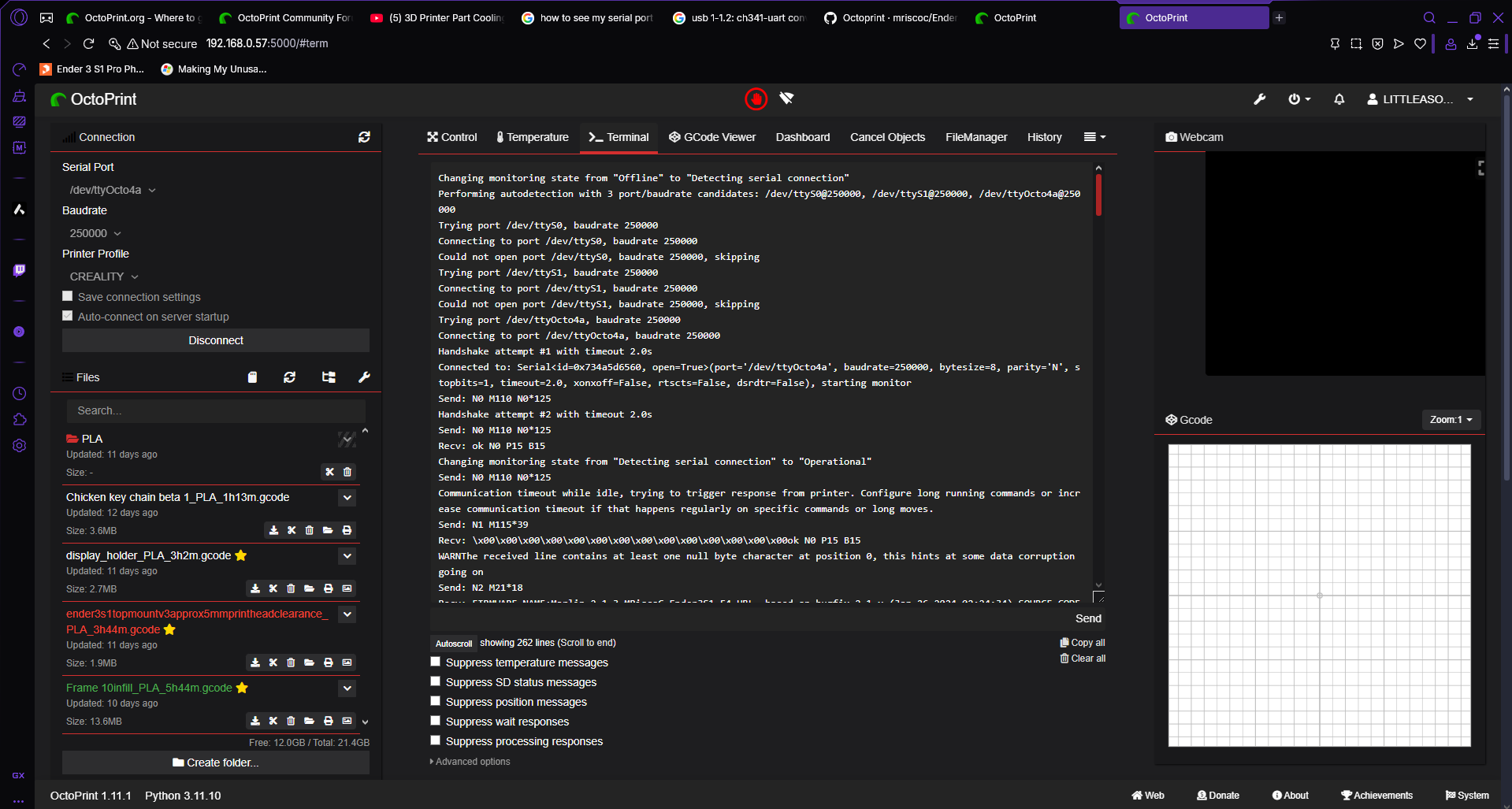

okay i did the usb and all the usb port works i tried reusing the current cable and rehooked it to octo4a and octo4a sees and connects to it. i also found No serial port found and there's a code in here dmesg -w that allows live feed of the usb and I'm getting connection kind of. it'll see there's something there but wont do anything. so both printer and pi are working but they just dont want to talk to eachother
For the record reason why i went to a pi instead of keeping the phone(octo4a). the phone(octo4a) wont charge while connected to the printer. I don't have a any other phones so when i went to go look for more i realized it was cheaper do run the pi instead of the phone
Okay i realized im transferring data from octa4a so ther serial port additional was wrong
instead of being usb0 it was octo4a once i change it to what it said in ssh it started working!!
