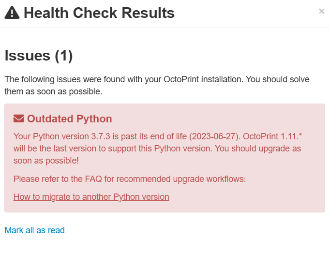

While the "Outdated Python" warning is ominous, you are not in danger until OctoPrint 1.12 is released.

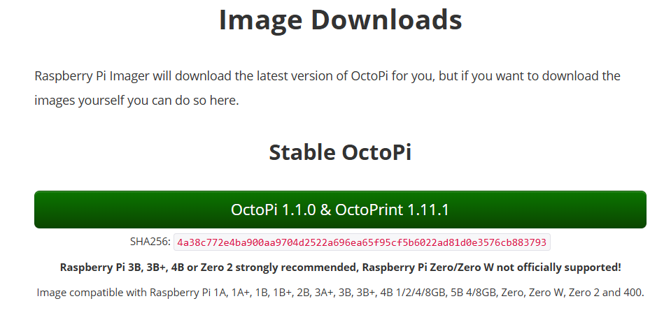

What image did you download?
