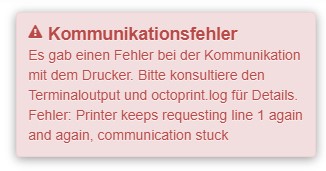

Yesterday I installed Octoprint on a Raspberry and finally wanted to use the system. Unfortunately, I can't establish a connection from the Raspberry to the printer - it's never worked before.
I have no idea how to narrow down the cause of the error or what I could do to make octoprint work with my printer.

I googled "my printer" and didn't find anything useful about the make and model of "your printer". Please enlighten us with some details.
What we can see from your bundle is that your Raspberry Pi 3B is suffering from a power issue. This should be fixed. Your printer may also be drawing power through the USB port and you may need to isolate it. See this topic or search this forum for "backpowering".
Really need to know the printer. I saw "skip 0" which I am not aware of being used in Marlin firmware. Off hand since it never accepts line 1, it could be it doesn't want checksums.....

It's a Renkforce RF2000. This one isn't that common.

In the Settings->Serial Connection->Firmware&Protocol you can turn off checksums to test.
