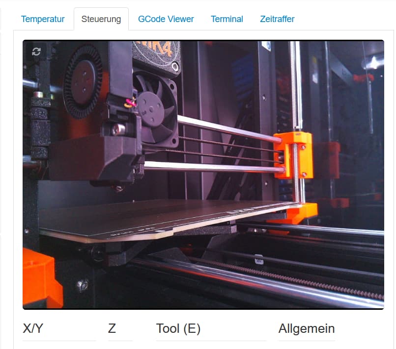

But the stream is not working in Octoprint...
But I did get a stream working with:
#disable webcamd to release cam control
dduese@fabricator:~ $ sudo systemctl stop webcamd.service
#start stream
dduese@fabricator:~ $ rpicam-vid -t 0 --inline --listen -o tcp://0.0.0.0:8554
[0:38:03.187263463] [1326]  INFO Camera camera_manager.cpp:326 libcamera v0.5.0+59-d83ff0a4
[0:38:03.219133296] [1329]  WARN RPiSdn sdn.cpp:40 Using legacy SDN tuning - please consider moving SDN inside rpi.denoise
[0:38:03.221833204] [1329]  INFO RPI vc4.cpp:447 Registered camera /base/soc/i2c0mux/i2c@1/imx219@10 to Unicam device /dev/media0 and ISP device /dev/media1
[0:38:03.221938387] [1329]  INFO RPI pipeline_base.cpp:1121 Using configuration file '/usr/share/libcamera/pipeline/rpi/vc4/rpi_apps.yaml'
Preview window unavailable
Mode selection for 640:480:12:P
    SRGGB10_CSI2P,640x480/0 - Score: 1000
    SRGGB10_CSI2P,1640x1232/0 - Score: 1444.49
    SRGGB10_CSI2P,1920x1080/0 - Score: 1636.67
    SRGGB10_CSI2P,3280x2464/0 - Score: 2162.49
    SRGGB8,640x480/0 - Score: 2000
    SRGGB8,1640x1232/0 - Score: 2444.49
    SRGGB8,1920x1080/0 - Score: 2636.67
    SRGGB8,3280x2464/0 - Score: 3162.49
[0:38:40.911159850] [1326]  INFO Camera camera.cpp:1205 configuring streams: (0) 640x480-YUV420 (1) 640x480-SBGGR10_CSI2P
[0:38:40.912050184] [1329]  INFO RPI vc4.cpp:622 Sensor: /base/soc/i2c0mux/i2c@1/imx219@10 - Selected sensor format: 640x480-SBGGR10_1X10 - Selected unicam format: 640x480-pBAA
#0 (0.00 fps) exp 33251.00 ag 8.00 dg 1.00
#1 (30.01 fps) exp 33251.00 ag 8.00 dg 1.00
#2 (30.01 fps) exp 33251.00 ag 8.00 dg 1.00
#3 (30.00 fps) exp 33251.00 ag 8.00 dg 1.00
#4 (30.00 fps) exp 33251.00 ag 8.00 dg 1.00
#5 (30.01 fps) exp 33251.00 ag 8.00 dg 1.00
#6 (30.00 fps) exp 33251.00 ag 8.00 dg 1.00
#7 (30.01 fps) exp 33251.00 ag 8.00 dg 1.00
which I could watch on my laptop with VLC player without issues, so the camera is working fine, but not recognised, set up correctly for webcamd...
my current octoprint gui setup are the defaults (as far as I know)

Ok, after going down the rabbit hole I think I can answer my own question...
As I already stated problem occured when migration to OctoPi 1.1.0 was done.
One of the first things I noted was that the cam did not need to be setup under bookworm.
Previously with the help of "raspi-config" one could enable the camera or the "legacy camera support".
The legacy camera support (closed, proprietary) has been dropped in bookworm in favor of the new open libcamera stack.
Which seems to be the problem for mjpg_streamer and PiCam v2 module in this case.
I was able to produce a watchable stream via the rpicam-vid command (which uses the libcamera stack), but not with mjpg_streamer.
To verify I did compile an alternate stream provider (found after digging through some open issues in the octopi github: Doesn't work with Pi Camera 3 路 Issue #802 路 guysoft/OctoPi 路 GitHub). I did not try the experimental_mjpg_streamer (which was discovered by @jneilliii ) but rather tried one of the suggested alternatives in the mentioned source https://forums.raspberrypi.com/viewtopic.php?t=332154
碌Streamer:
Which was quickly compiled and tried out, and also did not work, at first...
After paying attention to the Raspberry Pi camera example I noticed that another command was prepended before the actual commands to start the streamer.
This libcamerify script is part of libcamera-tools and provides a v4l2-compatibility layer (according to one of the devs Pi camera not functional on Bullseye 路 Issue #1434 路 Motion-Project/motion 路 GitHub).
After installing the tools and executing the streamer with libcamerify the stream was displayed in octoprint.
As an experiment I switched to the "Stable OctoPi with New Camera Stack" image (which is currently still an OctoPi 1.0.0 based on bullseye) and restored (which is, by the way, very comfortable :+1:) my configuration there. And my cam worked out of the box without the need to adjust a single thing.
TL;DR
Raspi Cam v2 does not work with the current "Stable Octopi branch (OctoPi 1.1.0 & Octoprint 1.1.1)" but will do nicely with the "Stable OctoPi with New Camera Stack".
@jneilliii @guysoft Maybe a word of caution/remark on the download page about this behavior?
Thanks @dduesentrieb for the heads up, will add it to the release notes.
Hmm, ok I need to correct my statement.
Since jneilliii suggested another possible solution involving the octoprint_deploy script, I did setup a fresh octopi 1.1.0 install on a spare Pi.
And was surprised that the PiCam v2 did work out of the box without any changes... :thinking:
Enabling the autodetect option in config.txt it is automatically loading overlays of detected cameras. Which in turn, seems to give ownership of the cam to the libcamera stack (reported in this post and confirmed in the following) which is not supported by mjpg-streamer.
camera_auto_detect=1
So contrary to the needed steps in previous Pi OS versions, it is not necessary to enable anything (quite the opposite :wink:) on OctoPi 1.1.0 to get the RPi Cam v2 module going.
Leave it as it comes in the config.txt:
# Automatically load overlays for detected cameras
camera_auto_detect=0
@guysoft @jneilliii Sorry for the confusion, so maybe we need a setup guide or remark/note of caution on this behavior?
