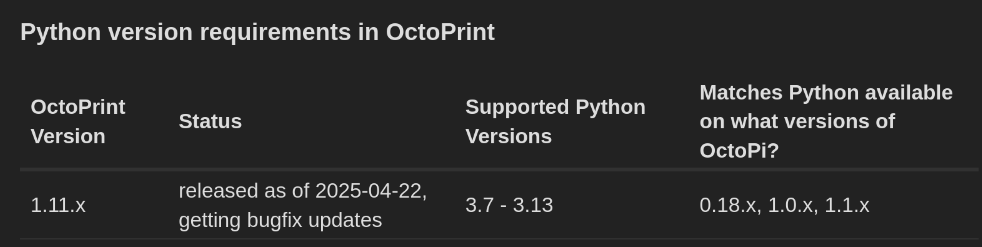

FYSA - Most recent Python version - Python 3.14 would not work. Error in PyYAML not being compatible. I reverted to 3.11
To quote the table from above:
OctoPrint 1.11.x doesn't support Python 3.14 (it wasn't released yet when OctoPrint 1.11.x was released back in spring) and while 1.12.0 will support it, the necessary compatibility fixes for that haven't yet happened either.
