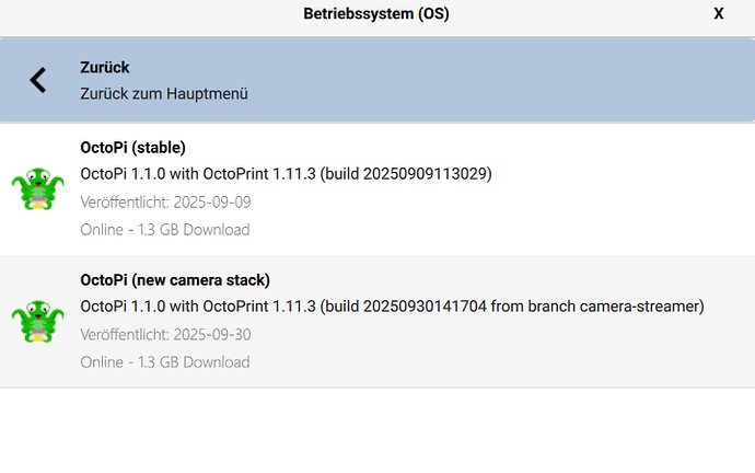

Hi
i just installed a new Octopi with Raspberry Imager, like suggested, but after Restart the same Error Message regarding Phyton 3.9 spawned!
Did i do something wrong?
i used the new camera stack version, that should be 30.September 25 ?!?
TIA

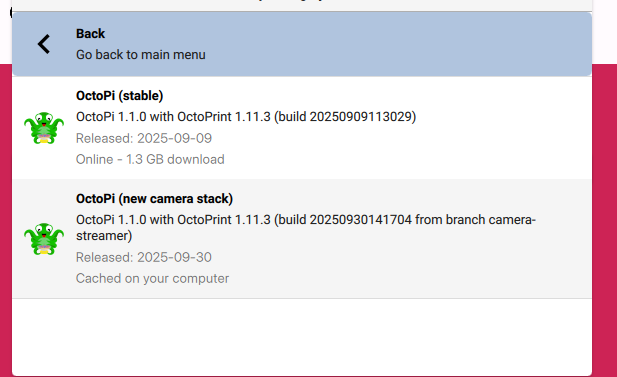

I downloaded the image manually, flashed it to a USB stick, and installed it on my RPi 4B. It shows:
OctoPrint 1.11.3 Python 3.11.2 OctoPi* 1.1.0cam (build 2025.09.30.141704)
If the image you flashed through the RPi Imager shows Python 3.9, then I don't think it downloaded the right image. @foosel might want to know this.
You can download the image manually and in the RPi Imager Use custom. See https://community.octoprint.org/t/new-new-camera-stack-rpi-images/64924/4
I just flashed the OctoPi (new camera stack) image from the RPi Imager (1.9.6) and it comes up as 1.1.0cam, Python 3.11.2
I also flashed the custom image via Raspberry Pi Imager, and I have python 3.11:
$ python --version
Python 3.11.2
Perhaps some caching issue?
jan
i will start from scratch and deinstall imager and so and then try again. as shown, it should be the right image! wish me luck :slight_smile:
Update: Now seem´s the new Image Version is Installed and all is OK.
I Hope the Restore of the Backup will not mess something :wink:
