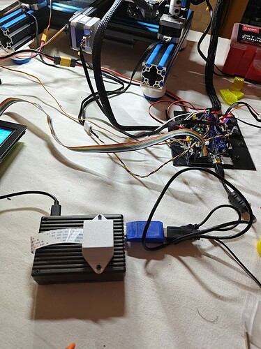

My printer is stopping all my test prints approximately at the same height.
My printer is in the middle of a rebuild and all the cables are lying around, I've even terminated some new ones (like the 3DTouch to remove the Dupont connectors and use proper JST-XH) and made extensions (Z stepper and Y endstop).
This is how the insanity is looking like:
I also compiled a new bugfix-2.1.x Marlin to update my 4 year old firmware. Board is a SKR Mini E3 v1.2.
What did you already try to solve it?
  • I tried moving all the cables in a way that they don't cross with the USB cable.
  • I tried several USB cables.
  • I even dug out an OLD cable from a portable HDD that had a ferrite core.
  • Tried with and without my shoddy "USB filter" that only has D+ D- wired. (it's the blue box between the Pi and the cable shown in my pictures).
  • Did my tests late at night when no other electronics in the house are functioning to rule out EMI.
  • I read through Printer disconnect mid print and all the linked threads, that's why I tried many things to rule out EMI.
  • My new pancake stepper motor came with a heatsink so I attached it since it was getting kinda hot.

I honestly think it's the Marlin firmware "bugfix-2.1.x". I should probably try compiling the stable 2.1.x version or even 2.0.x and see what happens.
Contrary to what the name bugfix might imply, that's actually a development branch and build you have running there. So yes, I strongly suggest trying a stable release version instead.

Yeah... I think I'll just go ahead and make a new stable firmware, since I know none of the points in the "SerialException" list applies to me.
Thank you Gina for taking the time to answer! :slight_smile:
So an update on this.
I did go back to 2.0.x and also had a serial disconnection. In the logs I saw that it was related to MeatPack so I disabled it. Did some dry runs first and some actual test prints later and everything turned out fine. The quality was pretty good too! :smiley:
So I'm positive this can be resolved. Maybe in the future I'll try 2.1.x again now that I know what to look for.
